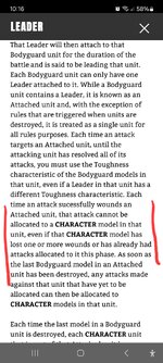

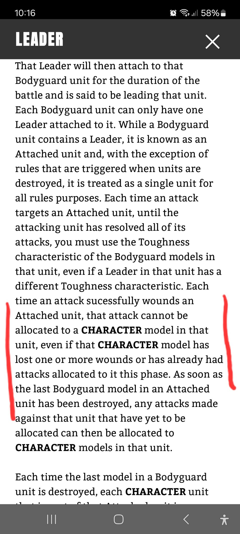

Die Regeln sagen dazu:
If a model in the target unit has already lost one or more wounds, or has already had attacks allocated to it this phase, that attack must be allocated to that model. Otherwise, that attack can be allocated to any model in the target unit. Note that it does not matter if that model is visible to or within range of the attacking model.
If a model in the target unit has already lost any wounds or had other attacks allocated to it this phase, the attack must be allocated to that model.
Du kannst also Verwundungen auf angeschlossene Charaktere legen. Sie sind ja Teil der Einheit. Machst du das, gehe aber alle weiteren Verwundungen während dieser Phase auf das gleiche Model, bis es hopps geht.
Mit Precision kannst du als Angreifer gezielt Charaktere auswählen.
