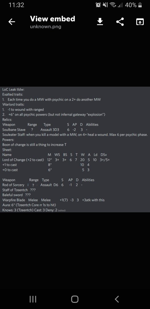

LoC: M 12", WS 3+, BS 3+, T7, W20, S6, A5, LD10, 5+/3+
+2 Psi, Core rerolls of 1
-1 to wound with shooting Attacks
Blade Option = 3 more Attacks at S7, AP-3, D3
+6" Range of Spells
Souleater Staff Relic = everytime the bearer kills a model with MW, roll a die, 4+ = 1 Life back
Rod of Sorcery Option = D6 Shots, S6, AP-1, D2
Lord of Flux = each time you do 1 MW, roll a Die, on a 2+ another MW
LoC has 3 Casts Base now
Leak vom Discord
