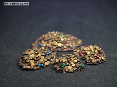

White Metal Games is a miniature painting and commission service specializing in producing custom painted miniatures for all your tabletop games, however, THIS LISTING IS FOR NEW PRODUCT. This auction includes: Dragon's Gold Treasure Piles. The perfect Dungeon Decor. You will get 4 Treasure...
